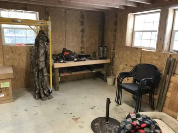

Yes on concrete. The area is 48'x 16'. it takes up one end of a 48'x64' shop. the area has an 8' ceiling due to the loft I have constructed. It is open to the rest of the shop which has a 12'+ ceiling. I am not trying to make the whole shop toasty, just want to take the chill out of the air in the end of the barn under the loft.
In the image labeled 1541 you can see the work area under the loft. Thinking of positioning the stove either where the shelves in the cent of the picture are or to the left near the wall where you see a mini fridge and milk crate.

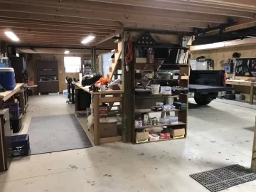

1542 is taken from the position of the other photo and shows the other end of the area i want to warm up.
  • [Hearth.com] Advice on selecting a stove
