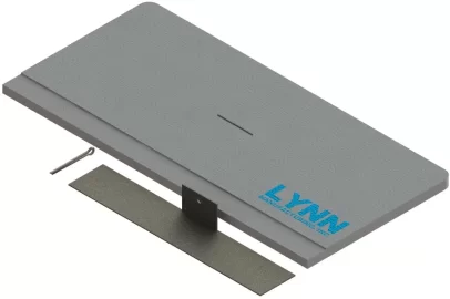

This one work? https://www.stove-parts-unlimited.c...one-heritage-i-baffle-board-2437a-p/2437a.htm

I purchased that Lynn brand baffle as a replacement for the original that was in my Mansfield a few years ago; I have no complaints and think it has worked rather well.
So I got the baffle. It comes with a metal piece with holes in it. No directions. They aren't taking calls and live chat was usesless. Does anyone know where it goes? I'm assuming it is to run the wires through and sits on top of the baffle but don't want to get that wrong.
