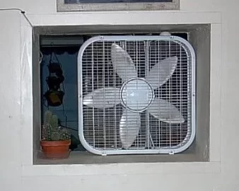

I use purpose cut holes for box fans on my interior walls like this, so my door ways are not obstructed. and I leave the fans on all year and it helps with evening out the house temps. so central heat or air we use window A/C units and these help even out those temps as well.
