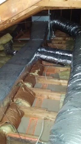

See some of my pics in this good post
https://www.hearth.com/talk/threads...lation-project-need-advice.68821/#post-865965
I was able to lift my existing insulation, air seal all top plates/wires/ceiling boxes and exhaust fan fixtures, then lay down another r38. Made a big difference, some of the top plate gaps were almost an inch!
I also pulled all my exterior electrical outlets through out the house, siliconed wire coming into box then caulked box to sheetrock.
I pulled front and back soffits, air sealed and r30 insulated
