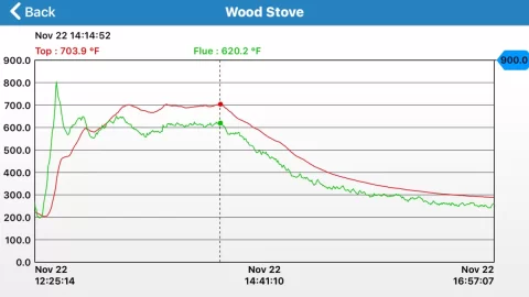

I have the same stove with the same concern. Lowering the air will not cool the stove. I’ve had many scarey moments. 800+ F seems to be the norm. I even have the secondary air restricted In hopes of gaining more control but that hasn’t been the case. This image is 5 med size splits packed tight N/S. Only about half the firebox.
Was the peak flue temp right before the air was turned down?

From what I have tried it makes very little difference when I shut the air down. It always gets up to about 800 stove top just take more or less time to get there.
Yes, Don that’s the same as mine. End result is always high STT. Just might be a little sooner or later In the burn cycle.
You may be dealing with slightly greater draft and have a different secondary config. After many years I get pretty predictable heat from the stove and can govern it from 500 to 750F. But to achieve the lower temp I need to do partial loads. That's ok because I only need to do that on mild days when one morning fire suffices. With a full load the stove top is going to be at around 650F to 700F depending on how tightly I pack the firebox and how quickly I turn down the air.
it's almost counter intuitive but these stove produce more heat with the air turned down. turning down the air only closes off the primary air supply, the secondary air supply(s) is still wide open and secondary burns (smoke and gases) are what produce a lot of heat. this is working as intended. it's nothing like the old airtight smoke dragons where closing them down turned them into smoldering creosote machines
