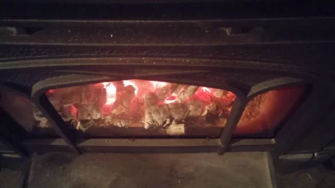

Here is a pic with a load of 18% Ash in the coal stage. Here it is left side only. This color is about typical.

You have logs rolling against the glass; of course it will be getting black in those spots. That has nothing to do with the air wash or the wood you are burning.
Nothing against the glass.

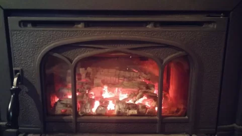

  • [Hearth.com] Air wash, operator or draft?

Well, maybe I'm not looking at it right, but I don't see much there to be concerned with or that is abnormal. If you want to see a properly dark window, talk to the Blaze King folks! Although that's a different animal altogether. Just by the pic, you're window looks fine to me.
Are your air controls on the right side? If they are that means you have cool air traveling along that side of the stove before it enters the firebox. This will tend to keep that side of the box and glass cooler causing the soot deposits. I see this on my quad glass from time to time. one load will burn clean and the next will make it dirty. It just happens sometimes.
Okay, I can see what you mean now after another look. If you are getting that on each burn, then it could be improved upon, but it could be a lot worse.
