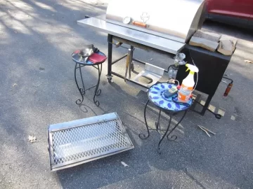

The Maverick was my first BBQ thermometer. It stopped working after a few years. A number of us at thesmokering.com have moved over to one of the Thermoworks BBQ thermometers. I bought the Thermoworks TW8060 kit with two probes for my smoker (TW8060-KIT-H-S).
BBQ last year. TW8060 and Thermapen on table. Delivery driver had just dropped off the charcoal insert that's on the ground by the smoker. Delivery driver didn't know what was being delivered. I said it was an insert Pitt's & Spitt's started making so I could use the smoker as a large grill. He was interested and wanted to see it. :)
