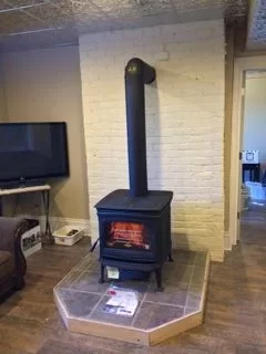

Hello everyone, this is my first time posting but i have certainly taken in alot of knowledge browsing the forums.
I recently installed an Alderlea t5 wood stove in my 1880's house. I am having difficulty getting burn times in excess of 3 to 4 hours even with the damper turned down to a very low level. I'm burning maple / yellow birch primarily and i'm not certain of the moisture content (moisture meter on order) but, it does light fairly easily.
I have read numerous people posting they are able to get 8 to 9 hour burn time with this stove it seems hard to believe with the times i have been getting!
Thanks in advance!

Hmm good question, it is a fairly tall house. Ceilings in the basement are 10ft main floor 12 ft top floor 10ft so thats 32 ft there (add in 2ft for floor joists) 34ft and i would add on 8 ft for the attic / masonry chimney. 42ft... This seems a bit much but it would be close i'm sure.
The tech called back and disagreed completely with me on the upgrade.. he said he is certain its capable of handling it. Disagreement aside he said they would swap it out for the t6/summit recertify the install and remove the old stove for 1381....

I think the chimney is part of the problem. The draft is too strong. I suspect that the flame is being sucked right up the flue. If this is the case a T6 is not going to solve the strong draft issue. Your stove shop should have caught this. Anything over 30ft. is considered too tall. The stove prefers a chimney half the current height.
Before giving up on the T5 put in a simple key damper about 18" above the flue collar on the stove. After the stove is burning strongly, close the key damper all the way. That should slow down the burn a lot and dramatically increase the heat output of the stove.
