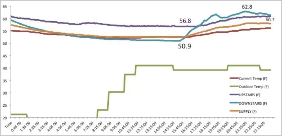

Thanks for all the feedback, the attached graph is the readings from my sensors for yesterday. My wife started the fire when she got home from work and by the time i got home there was a good coal bed for me to refuel. She had used softwood to get it going and i had added in some fairly large splits of Maple.
I can do a similar test tonight but fill the firebox completely. [Hearth.com] Alderlea t5 Burn Time

I did another test last night and I was able to get better burn time out of the stove… I think that one of my issues was the handle was not seating the door properly. I had to give it a good whack a couple of times and open and close the latch to get it to go fully into position easily (easier…)
I lit a starter fire with softwood and let that burn down to coals. Then I loaded the red hot coal bed with three large splits of yellow birch. Once the fire was fully involved (after 10 minutes or so) I closed the intake completely (previously I had only been moving it to L but it will go about 1.5 inches past that) The fire burned with a lazy waving flame that didn’t look like it was being sucked directly out of the stove.
I figure I was about to get about 7 hours of heat from the stove.. which was better but my temperature readings on the three floors weren’t that different from the ones I posted previously.
When I purchased the stove they had told me to only set it to L and not all the way closed. I had played with this in the past and the fires had died down very quickly / went out and I think the wood from the last batch had a bit too much moisture in it.

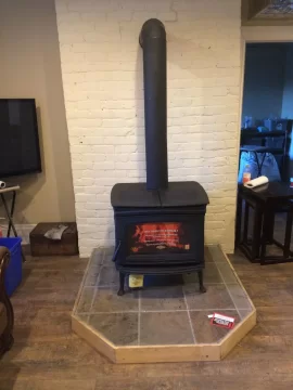

The T6 was installed this morning, i can see a noticeable difference in the size of the firebox and i'm really looking forward to testing it out after some initial smaller fires.
I have been using an electric fan to blow air around and i'm wondering if anyone can offer a suggestions for an aftermarket stove fan?

Doesn't the T6 have a blower option?
Looks good, that's my dream stove.....
