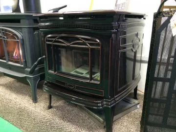

My local dealer had a floor model discounted of the T5. I noticed after the last time I was there that the door on this particular unit ( pic attached of unit in the store) seems more decorative than the latest on PE website and pics of some units you all have posted.
In my hours of reading on this site I saw someone mention of it but cannot find that post again. Figured I would check and see if someone knows and if so, is this an older unit? Were there upgrades made to the more recent unit??? Like this door much better but performance is obviously my focus.

This would be an older model because they discontinued the decorative work on the door. I bought my T6 last September 2014 and it did not come with the decorative door. I wish it would have because it looks great. I know they added the EBT (extended burn time) technology to the newer stoves, but I can't speak to when they did it. Begreen would be a great one to ask.
It would not take much for PE to offer the grillework as an option. Keep requesting if desired. I'd take it over the ash pan.
That is a great looking door on that stove. The design on my T5 is identical the paint work however is not. Beautiful looking stove, the performance should be excellent. Love mine.

No EBT on the 2 cu ft PE stoves. They have a secondary air control linked with the primary that allows great control and some pretty impressive burn times.
I think only the T6/Summit and the new Neos have EBT.

I bought my T5 from some very nice people in PA. It was an unfired demo unit in their showroom with the decorative door. I called PE to see if I could get the build date based on serial number and they said if I wanted the new door, they would exchange it for free. (I think it was a 2010 or 11, but I know 2012 was the new door.) A kicker was the warranty didn't even start until I received the stove. Great performer. I loaded it last night at 11:00 and was up at 5:30 with snow starting...the house was 71 degrees. Starting the big test right now as the morning low is expected to be 9. :) Here we go!

Ok, T5 floor model is now mine! Purchased today, hopefully installed in 3 weeks they say...... Now to go scavenge good quality wood (good luck me).

That's what I was thinking, glad he went that way....thing looks sweet in that green! ()
