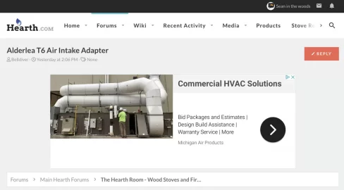

This is a bit off topic but I thought I’d post anyway...
Normally I ignore the advertisements that are added to the posts on this site but I had to do a double take when I saw this one on your thread. My first thought was “That’s one heck of a big air intake adapter.”
[Hearth.com] Alderlea T6 Air Intake Adapter
  • Haha
Reactions: begreen
