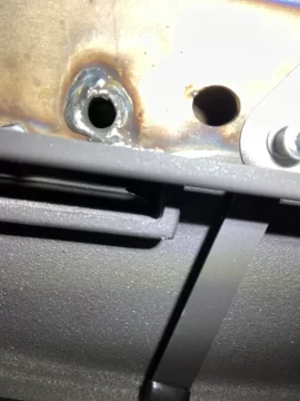

Definitely try blocking the doghouse boost air.
The boost air hole is not blocked, I don’t remember that being discussed. Is that something I should also try?
Yes, it's easy with a magnet or metal tape. Take a mirror or a cellphone to look for the small boost air hole. It's about 1/4" diam. and may have a weld bead around it. The hole is located on the bottom of the stove, underneath the stove door, either center or to the right as you face the stove.

No, just a relatively strong one. Can be flat or round. If the weld ring is too uneven then the tape may work better or a plug made from a short section of 1/4" stove rope gasket. You might even be able to thread a bolt in there or fashion a pointed plug out of some aluminum foil. A fat dab of RTV cement would also work as long as it was allowed to set up.
I ended up going with metal hvac tape. The hole on mine seemed much larger than what I expected (mine is a mirrored image of the one you posted because I had my camera on selfie mode so I could see). I’ll see how this goes!
