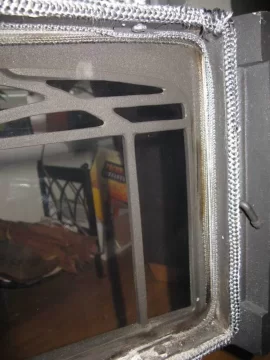

I'll check the thermometer in the oven. The ash chute seems ok, but when I examined the gasket on the front door, the gasket that runs around the glass is twisted on both sides (the side section of the glass, as opposed to the bottom and top). Is this by design, or should that gasket run flat along the glass the whole way?

The window gasket is somewhat oversized. The part of the gasket that hangs outside of the glass will twist and bend over. That is normal and not an issues as long as there is a good contact seal between the glass and the other half-width of the flat gasket. On our stove this contact area varies between about 1/8 and 1/4", with less as it bends around the corners and more in the middle.

Thanks BeGreen, can you have a look at your window gasket and tell me if it twists on the sides?

The excess may lay flat or it may twist. As long as the captive part is flat between the glass and stove door, it should be ok. This is what our glass gasket looks like:

This looks the same as mine, thanks. So, if I'm sealed up ok, my next option would be to invest in a blower. Our installer said that dampers on flues are illegal in Alberta. Not sure why. I'll continue to increase the number of splits that I add to see how many I can get away with. It would be nice to load her up to get all night burns. At what stove top temperatures should I get concerned?
