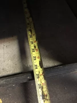

Does anyone know what size this all nighter is? It has never been used it was in a garage and never had it installed

The top looks odd. Can you post a full stove shot?
The two models with step top and double intakes can be a Mid Moe or Big Moe.
Mid is 36 inches deep overall, Big is 41 1/2 inches deep overall.

The log length is incorrect on the Mid Moe specs. I think it should be 24, not 28. If yours is a Mid Moe maybe you can tell us if it takes a 24 inch log straight in maximum.
Thanks, yes that's a Mid Moe.

Looks like an Econo. Mid-Moe without the internal blower tubes . This would be a cheapest version for the Mid - Moe model .
