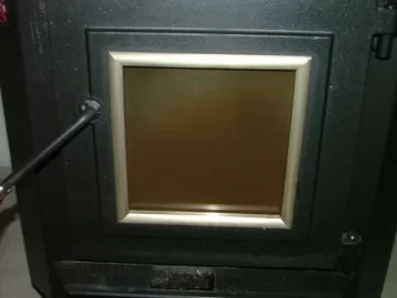

Turned out they were the light ones. So figured I would just burn them up and set the stove to 9-9, but ran into a problem, about 2 1/2 hours later, the better half wakes me (I dosed off watching the news) and says that there is a terrible smell and her eyes were burning. I knew the smell, paint, metal smell and went down to check the stove. Well it looked like it was out, glass totally dark, so I figure ok the fire was out and that there was a bunch of smoke as to the reason why I didn't see any thing. So I pressed the Off button and gave it a couple of minutes, but the smoke didn't seem like it was clearing out... I decided to open the door a crack to peek in... Bad mistake... Flames came shooting out.... Holy Crap!

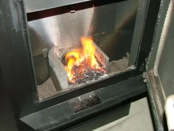

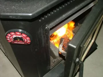

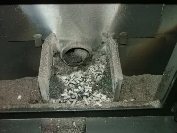

The door was just covered with soot was the reason I didn't see anything. I made sure it was in Shut down mode and sat there and waited about 5 minutes and peeked in again but there still was quite a fire going. So gave it a few more minutes and checked it again, fire down a bit and then I could see that the burn pot was filled and over flowing.

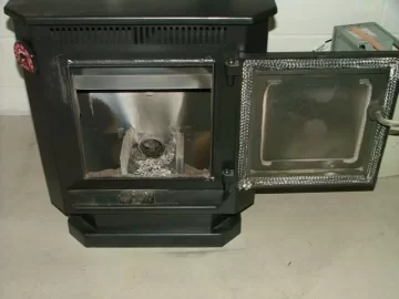

Went and got the camera and took a couple of pictures, a couple were taken about five minutes after I put the stove in shut down peeking in the door. The picture of the Closed door was taken while the fire was still going. The others showing the filled burn pot.

To me your stove seems to have a lot of ash in it. Not just the burn pot but in the sides. Did you give it a look below the burn pot plate? If it got a lot of ash under there it could be that it just wasn't getting enough air to burn the pellets. That would have made a rich burn and made the window black.
If you did start with a really clean stove and the ash on the sides, in the burn pot and under the burn pot is all from one bag of pellets, then I'd say try some other brand of pellets.
What I have read about Pennington they sound like they are hit or miss. When I see them in the store I pass them by. Some people say that some batches make a lot of ash. Maybe you can burn them at a lower setting of say 6 6. Maybe that will not over feed them and give the stove a chance to burn them up.
I would also pull the pipe off the back of the stove and make sure it is not restricted by ash. I run the same stove on 9/9 all the time and have only seen this when something is restricted. Give it a good cleaning, make sure it is clear up through the pipe and it should be fine.

bret4 - the ash on the sides is from 2 days worth, pictures make it look like more. The burn pot and under the ware plate was cleaned and scrapped when I started with these pellets, and Yes a lot of ash and a lot not very well burnt pellets.

Yes I am leaning towards the pellets as because of the ash and incomplete burn just too many to fast with no where to go.

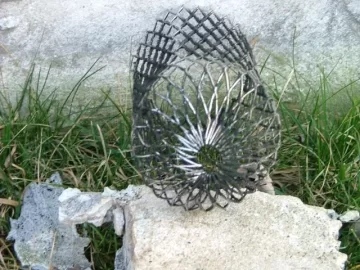

blanc12 - Well double checked the exhaust vent and Yes there defiantly was a restriction. Go figure ;-)
When I purchased my stove one of the guys suggested to put a vermin screen on the exhaust, so I found a screen that goes in gutters and thought that would work… well.... that was plugged up with soot… I would not have thought it would have had plugged up in 3 weeks or so, but I guess because I've been running the stove on low most of the time as to why the extra soot build up and then all of a sudden switch to 9 might have had something to do with it. Attached is a photo of it but the soot all fell out when I removed it..

mike the stoveguy just got back from vacation , (week of golf at myrtle beach) so i didnt see this til just now. guess im late for the game of "clue" i see that it was the "vermin screen" in the exhaust with the asphyxiation :) as for the unit running on high it will, although i usually recommend it as a "sprint" setting , to warm the space quickly then throttle back for maintaining heat. yes it does have an "over heat limit" which stops the top auger until the unit cools at the sensor to a more realistic temperature , it may have been so loaded up from the restriction and the high setting that even with the top auger no longer cycling it still had a bunch of available fuel to burn. the last thing you want with that large an amount of fuel in the ifre is to just shut down, it has to burn whats there and cool before completing a shutdown so looking at the pictures and the pile that was in the front of the pot i understand how the unit was still burning after more than likely tripping the high limit.
by the way , with that screen in the flue pipe , i'd feel confident that any brand of pellet could cause this happening , this wasnt the fault of the pennington pellets , as for a rodent screen , i'd think about maybe installing it in the end of the season and take it back out in the fall, but no self respecting rodent is going to crawl down the vent of an active p-10 unless maybe its a lost lemming who couldnt find a cliff to jump off of, or maybe he saw a few movies and decided "its better to burn out, than float away" :)

Lemming's, some of the levels are tough trying to figure which ones to sacrifice. And yes after I removed it thought it best to leave it out since I don't think anything would likely crawl in there till around April or so. :-)
