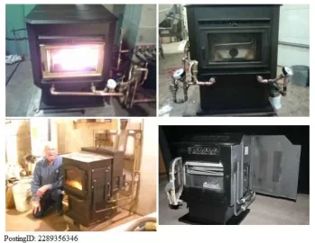

This should take the prize for the MOST altered Wood pellet Stove!! Pellet Stove Boiler Mod !!
(broken link removed to http://nh.craigslist.org/hsh/2289356346.html)
TURN YOUR PELLET/CORN OR COAL STOVE INTO A BOILER , AND DOUBLE THE BTU'S FROM TWO TYPES OF HEAT AT THE SAME TIME, NOW HEAT OTHER AREAS OF YOUR HOME FOR FREE USEING THE SAME AMOUNT OF PELLETS ,CORN OR COAL, CHECK OUT. http://www.CROSSLINKCONVERSIONS.COM WEB SITE AND READ THE FORUM .LETS CLEAN UP OUR AIR PASS THIS ALONG
See pics below !!!

Sounds like a "perpetual motion machine" to me. He's extracting heat from the fire, which leaves less heat to warm the heat exchanger. That means a net loss of heat into the room. There's no free lunch, it's not like they're using waste heat going out the vent. And that's another can of worms - whether removing heat from the exhaust is a good idea or not.
I'd also like to know how he keeps from boiling the water that's in the tubing inside the stove. Sure, keep it moving, but the heat has to go somewhere after the water in the system is fully heated.
I'd like more details.

As to his coil, it is not wasted heat - as you know, part of that heat would be taken from the stoves heat exchangers and the rest from the flue gas temp.
He would need to have constant circulation to prevent boiling.....and with that puny coil, we would not have to worry much about overheating a loop...BUT, if the pump failed or something like that, it would probably boil within a few minutes or less.
Not to say that stove and fireplace boiler systems are not a good idea...they have been used for a century or more in Europe. But they are designed into the stoves and properly rated, etc....
