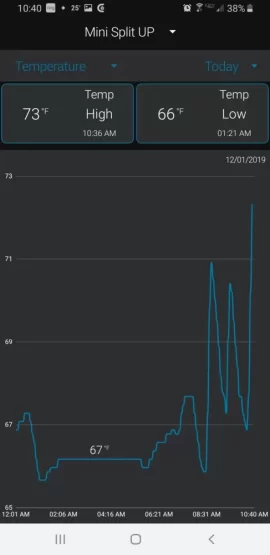

Here is a good graph on how good a mini split can maintain an exact perfect temperature. The air was bone dry (outside dewpoint of 9) here so I switched over to oil to run the whole house humidifier.
Notice the perfectly maintained 67 degrees overnight and then the wild swings of the furnace when it went on around 8am
These things are amazing for running super quiet at only the btus required for the heat loss.

That hysteresis is pretty normal when taking a space up 5+ degrees, even for a mini-split. The oil burner heated up the place quickly and shut off as the thermostat was satisfied. But the actual room mass and contents had not warmed up fully, just the air. Once all the chairs, sofas, walls, floors, etc. are up to temp, those temperature swings should be much less, even with the oil burner running, depending on the swing setting of the thermostat.

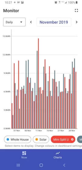

I ran both my mini splits for pretty much the entire month of November set to 70. The results were impressive considering Nov was a really cold month here. I did have a fire or two but have been finding that mini splits do very little to indoor winter humidity so I have been having less fires. Every time I have a good hot fire its crazy how fast my indoor humidity drops. My wife is very sensitive to dry air.
I monitored the electric consumption of both my 12k splits. They average around 6 kwhs a day it seems and combined consumption was 448 kwhs. I have solar panels but at CTs electric rates of .20 a kWh it would have cost $89.60 for the month. The national average is like half that so many would cut that in half. Seems like a bargain for leaving the tstat at 70 for the month.

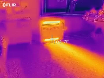

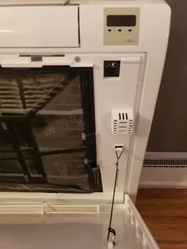

I have a floor console unit. Its superior to my wall unit downstairs in heating. The big advantage is the return air sensor is measuring the air a foot or 2 above the floor. Wall units are measuring the much warmer air temperature just below the ceiling height. The floor console units are also drawing the air in from the floor. The performance is stunning. The air outlet can be set for top or bottom or both. It puts out great warmth across the floor. Here is a flir shot of the unit in operation.
2nd one is the air sensor located just above the string on the door.

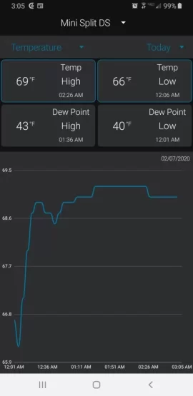

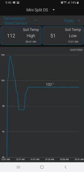

Its also pretty amazing how good they can regulate a constant near perfect temp. I have a return air and supply temp sensor on mine. It just locks right on the setpoint and maintains it perfectly.
Here is the supply/return temps when I had the unit turn on at midnight set to 69 degrees.

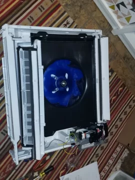

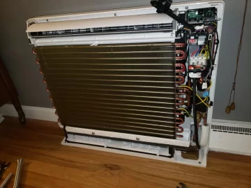

The floor units are 10 times easier to clean and take apart. The coil is completely exposed. The coil can also be easily be moved out of the way to access the fan. The refrigerant lines dont need to be removed. Wall units require special cleaning hoods and the flong fan wheel can be a nightmare to acess and clean. The floor units use an actual round fan blade.
A ceiling unit would be great for cooling but in heating mode it would be drawing in the hottest air at the ceiling level. All the cold air is going to sink to floor level. The colder the air intake the efficiency goes way up. I have a wall unit as well and the floor unit blows it away in heating mode. The floor level is way warmer than where the wall unit is.
On my house central air all the returns were at the floor level. I installed new inlets with dampers at the top of the wall. The difference in cooling was staggering as I was now drawing in the hottest air. In heating mode I use the floor returns. The results were impressive.
