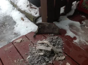

So I was issues with my bypass door and ordered a new one. Went to install it and noticed my cat wasn't looking so good. Called Woodstock and they sent me a new one for only the shipping cost. While waiting for it to come in noticed that the bypass door was giving me more issues. Figured I would just wait for the new cat and then open the stove back up to do the door and cat change out. Well you can see by the pic the door was actually broken and the cat just crumbled up when I took it out.
All good though as the door was easy to replace as well as the cat.
All through this I was emailing back and forth to Woodstock asking questions on why the cat went bad ,etc.they always responded with detailed info.
In the end I think I messed up the bypass door by letting the pipe temp get way to high before engaging cat. Now I have engaged cat when the pipe temp hits 300. The new cat is glowing nicely and I am back up to steady 600 stove top temps.
The cat they say was the ceramic kind which they said phosphate from the wood damages it. That's why it's now stainless steel
So now the door is sealing tight , cat is working great and the main thing is they back what they sell and support it to the max. Would always recommend Woodstock for their service and product as this isn't the first time I needed them

That pile looks very familiar. I seen this many times with my old dutchwest wood stove. If Woodstock would have had a stove that would have heated 2400 sqft at the time I was looking I would have probably went with them. I have NEVER heard anything bad about them. Glad your stove is working as it should again. You need all the heat you can get. It can get mighty cold in these WV hills;lol

Single wall pipe and was getting it up to 500 to 600 - way to high I now understand
The old cat was ceramic and the new one was ss

Do remember that 500 to 600 on the surface thermometer single wall pipe convert to internal temps of 1000-1200. Hotter than you want by a long shot, and tons of heat going up the chimney and heating the great outdoors.
