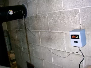

Well here is something better than a rubber band on the wrist. Here is what I have done. I have put together a stove temperature monitor/ alarm. There is a thermocouple probe in the flue connected to a controller, the alarm will sound when the internal flue gas temperature exceeds the set point.
I think you would be surprised just how fast the flue temp can rise. Tonight I when I started up my stove ( it was cold) the flue temp went from 60* to 500* in about 3 1/2 min, this was with the door slightly open and some pallet wood kindling. After I shut the door the flue temp was up to around 700* in 10 min.
Here are some pics and a link to a video.
