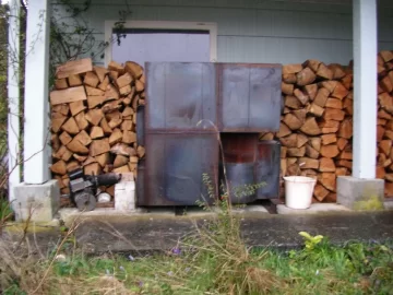

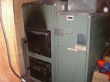

This is a 35 year old combination furnace.
[Hearth.com] Always smoke in the house
Side profile of the heat exchanger removed from the housing.

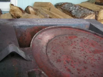

The top of the wood burning chamber is almost burnt through, possible pin holes .

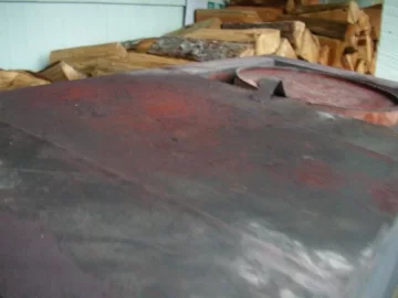

Top of the oil burner section severely cracked .
