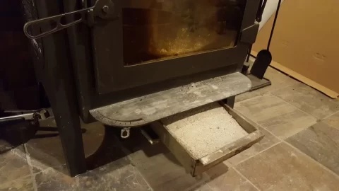

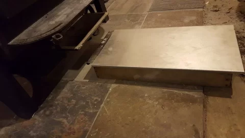

Well. So far the Ashford is a really nice and efficient stove, does anything as advertised. I had some trouble with finding the absolute lowest setting on the damper. Turns if I set to as low as it could go, the fire would go out. I think it is lack of draft, we went with the absolute minimum stack height for the overall look of the exterior of the house. Also I don't like the ashtray system when comparing it to mine. Now I know ppl don't like a gasket seal ashtray but the convenience of cleaning is second to none. One last thing the glass gets dirty quick on the Bk, compared to my airwash glass on the PH which I haven't cleaned in over a yr. Granted my glass is due but that is more ash causing a blurry view as apposed to black sediment constantly on the BK. So after a 6 weeks or so BK and PH are about neck and neck heating and doing what a woodstove is supposed to do. Bk with the longer burn times, not by alot 15-20 percent longer. But the PH with the better Heat output and solid burn times. But where I found the PH out does the BK is smaller day to day stuff. I like drinking my coffee before work and watching morming reload burn up, and that airwash is there to make that happen. Cleaning out the ash is a breeze. And like putting Gas in her van, putting wood in the stove is something my wife just seems to forget! But no problem, the PH will pump out the btu's to heat the house warm real quick.
Sent from my SM-G900W8 using Tapatalk
The Ashford ash system sucks. I'll give you that. In fact, I've recently given up on using it altogether, and switched over to a metal bucket with a shovel. It's a shame BK did not give better consideration to this.
On the glass and airwash, it's hard to follow your complaint here, but are you saying your glass is black? You must be burning wet wood, or failing to follow the instructions for burning on high 20 - 30 minutes after cat active engagement, if you're having trouble with black glass. I have two Ashfords, on chimneys of 15 and 29 feet, and both have clean glass. It only gets black in the lower corners on long burns, but cleans right up, when run on high with each reload.

I have no experience with Blaze King's ash removal system but the setup in the Ideal Steel is fantastic. I used to shovel ashes out of my Quadra Fire and that makes a big mess. The pan has a lid you slide on while you pull the pan out. It doesn't get any easier.
It gets even easier if you don't put the lid on. ==c
