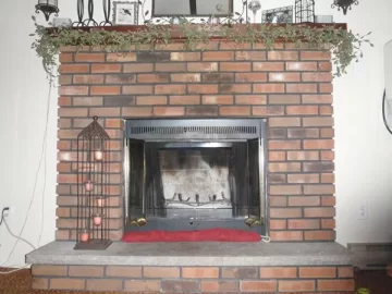

Trying to figure out why you would want to put everything back, you did all that work to have an alcove install and get rid of the fireplace. I guess each to their own.
Because it was a fireplace, hated the brick, cold air would come in when wasnt in use . When i did the project they didnt have these nuce looking inserts. Are they that much less efficient than the IR ?
You are sticking a box of fire into a hole verses it being able to radiate freely, you are going to lose efficiency no matter how much you insulate the hole.
