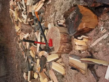

So..i stopped by tractor supply yesterdat and bought the truper 16lb monster maul to see how it stacks up to the x27..well i was dissapointed.dont know if im using it wrong or what...jus raising it over my head and dropping it on to the round...does it need to be sharpened?..i figured it was ment to bludgeon..lol..it def is a "monster"...any words of wisdom would be appreciated...

Just dropping it ain't gonna cut it. Even the big boys like that need to be swung.

Also you may need to nibble the edge depending of size of log. Cut edges then center depending on , dryness,species ,log size, there is a member with an avarat photo showing this. IMHO all splitting tools need sharpened, same as new knives

You're not doing it wrong. The Monster Maul is a 16lb hunk of s#!t.
Thanks redd..lol..well i sharpened it with a file...not much change...im gonna put the grinder on it to put a good edge on it and then try..it just aint a fiskars...fo sho...:(..dern thing wuz 50 bones...
also, in the right, err, bottom, of your pic,,, the round with all the red paint on it from the maul will generally always be a sucker to split as it appears to be the stump / butt end of the log.
Take the chainsaw and take the "whiskers" off of it and flip it over, and try splitting it again. Sometimes if a round won't split one way, it just needs to get whacked on the other end to get it to cooperate.
If you still have trouble, try noodling it with the chainsaw and/or taking a wedge to it.

That maul really is no good. A maul doesn't need a razor sharp edge as it doesn't really cut wood...it basically crushes and acts as wedge.
I tried that maul out. The damn handle is wicked heavy and steel, and because of it you can't get a good swing out of it unless you are some monster strong man.
You would probably have 100% more success with a 8lb maul from big orange and a plastic handle as the handle weighs nothing and you get a great swing because of the balancing (seriously head heavy) and you can get way more momentum behind the swing.
Get rid of it imo.

Actually the maul is not that bad. I have had one for a number of years. I also have a Fiskars. On some rounds the maul will actually do better than the fiskars, but you have to have enough beans in your buns to make that weight work for you.

Because the force calculation uses velocity squared, you are better off with a lighter axe swung at a faster speed. Fast & quick >>> slow and heavy.

my theory is that the way the tree grows is the end that splits best. i can tell when there are limb ends still visible. when no limbs, if I hit and it just absorbs it or bounces off, its the other end.

I have had a monster maul for many years and split a lot of wood with it, and just got an x 27 this past January. I immediately fell in love with the fiskars. It is all I use anymore. Having said that I still carry my monster maul with me and swing it a few times just to see if I still can. In certain woods it will split just the same if not better than the fiskars, but for an average over all wood species it's the fiskars hands down. With the monster maul, even though it's heavy, it still requires speed. And wih speed you need accuracy. Keep practicing and building muscles and it will do good.
