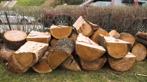

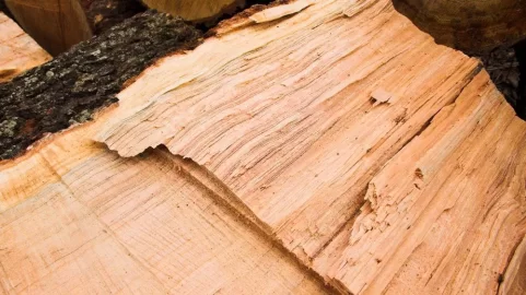

So anyhow, here are the money shots of the face-cord or so of pitch-laced cherry that came home with me this afternoon. Any words of wisdom as to how I might split this stuff without hydraulics would be much appreciated. [Hearth.com] OMG, do I really have to noodle cherry?

I'm guessing since this is suburbia that the tree basically lived all by its lonesome or in a hedge row for its life? If so, it took a heck of a lot more pounding than a tree in the middle of a forest would have. Because of that, I think trees that are "loners" are often times more difficult to split. Well, at least that's been my experience.
Also, it sounds like you need to get a good sledge to work a wedge more effectively.
pen
Looks like about $500-700 worth of turning & carving blocks to me.....;)
Beautiful wood.
A ten pound sledge and a spiral wedge will likely do the trick. (Spiral wedges available at Lee Valley online. They really work)
pen
I would second this. That has been my experience. Even normally easy splitting wood can grow twisted and gnarly. I have even had Ash that was tough to split. Do what ya gotta do.;)
I know, I know, but I don't currently have access to a decent lathe. I'm more of a furniture maker anyhow, so I tend to look for board-length pieces rather than chunks. But the thing that set me on the path to being a woodworker, maybe 25 years ago or longer, was a wall clock built from wood just like this. I'm trying not to think about how sad it is that the pieces aren't longer, and that I'm not so well set up for drying furniture wood right now.
Yes, it was a suburban yard tree, not confined or shaded in a forest. But then, the same could be said of almost all the other wood I've scrounged, and none of it has been so much like a sort of rubbery iron as this stuff is. There isn't even any twist to speak of.
I do need a bigger sledge. I thought I could get away with a large mechanic's hammer, but not so much with this stuff.

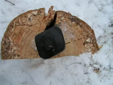

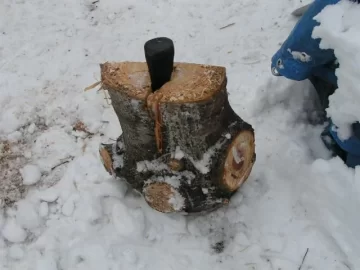

I really like them. Went right through this large knotty White Pine,5 hits with 4lb sledge.The Wetterlings & Mueller wedges are similar design,slight difference & a bit less weight.On Back Order so I should see them in about a month hopefully.Interesting to see how they compare.

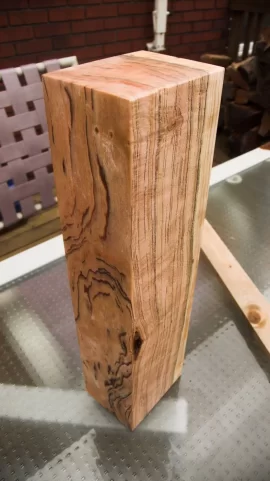

I took a piece to the shop today and cleaned it up. I'm not sure I'm allowed to burn this stuff...
