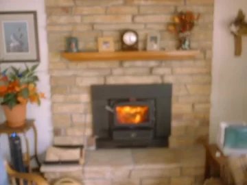

Buy a magnetic thermometer and place it above the door, as show in the attached picture. You should be able to get the temperature up to at least 450 or 500 degrees. I'm guessing that your problem is that the fire is not hot enough.
Leave the air control all the way open until you get those high temperatures. I never stop it down more that 50% or so.
I'm confident this will work for you. Let us know.

i have this same insert first thing i can tell you is dont waste your money on a magnetic thermometer there is no good place to put it i tried. my house is about 1500sf i fired up the insert about 5 hours ago when i got home from work temp was 59 now it is 74 in room with insert, around 70 in rest of the house , i have a ceiling fan in the room with the insert and one in the kitchen i run all the time moves heat around very well , i did do a block off plate, have blower on insert i run on high when i want fast heat. i also run fan that was on the zc fireplace that i put the insert in to, it pushes heat out from behind the suround. i hope that helps
