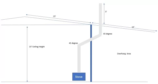

I am installing a small wood stove in my pole barn and I just had a new metal roof installed. My gut is saying that I don't want to cut a hole in that new roof for the stove. Here's some more info.
  • The interior wall height is 13'.
  • The side of the barn where I want to install the stove has a 15' overhang where the roof line is extended over it.
  • Interior finished space is 30x30.
  • I'm thinking of running the pipe up the interior finished part of the barn 10' then use a 45 to punch through the wall and another 45 to punch through the roof line that covers the overhang.
  • This way, there is no chance that my new roof will leak inside the finished area.
  • The pitch of the roof is12/2 and the pipe would come out of the roof approx 18' from the peak.
    • I assume this means that the stack coming out of the barn roof would need to be (18x2)+24 or 60" high.
I've attached a brief pic that shows what I'm thinking. Am I at least in the ball park here? I appreciate your thoughts/input/advice.
... Bored in Ohio

I would go straight up and through. You will have better draft and will need to buy less expensive chimney pipe. Properly installed (that is the catch) water leaks should be unlikely.

In the perfect world can you orient the stove under the peak? That eliminates alot of a leak potential. The rubber boot type flashings work really well in my experience. Having the pipe coming out at the peak eliminates the snow slide situation. My .02

You don't want to install it the way you have drawn it out...they don't make 45* fittings for chimney pipe, and you don't want stove pipe outside of the heated area. I agree with the above, just go straight up.
What is the building going to be used for?

It's a shop. The other issue with running it up through the peak is aesthetics. If I put it under the overhang, the chimney pipe will be barely visible to others. But, if it's a bad idea, it's a bad idea. I tend to overthink the holy S*(t out of everything.

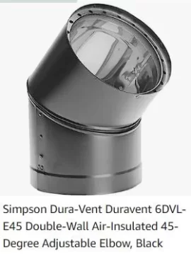

I'm obviously missing something because a quick search return several 45* fittings for just this purpose.

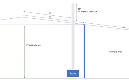

Thanks for helping to clear that up for me! Here's a revised option. It's going to kill me to cut a hole in that beautiful new roof! I've lived with it leaking for 15 years!
I prefer to have the stove in the corner because my wood will be in the overhang area closest to it.
Is the 44" rise over the roof line look ok?
I'm a pretty handy person, but I will likely have a local installer do it just to make sure I don't burn my barn down with that nice new roof!
That is stove pipe, not chimney pipe. The moment the flue system transtions thru the wall or ceiling to outside of the building the piping must be class A chimney pipe.
Add my recommendation is also for straight up.

You will have no trouble with a leaking roof. ....trusses 24" on centre or wder? . ....location of the truss will dictate stove location from the wall as well. If it was my place I would be using stove pipe up to the ceiling then chimney from that point up. This would be a install I would tackle myself. It's really straight forward with minimal amount of concealed pipe. Clearances MUST be respected, but in this case I think it's easily managed. But if your not comfortable, pay someone to do it. Ordering the pipe and chimney kits online or from a stove shop should be easy.
