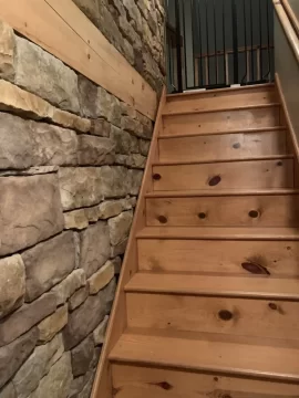

I recently bought a timber frame home and fell in love with the great room and it’s fireplace. I grew up with a wood stove and was excited to buy an insert. Until I learned the fireplace is a prefab. I’ve read quite a bit about that dilemma and it seems the general consensus is to tear down and replace. I’m attaching a picture (blacked out some personal artwork)
Am I to expect all of this stone coming down too? Even if I just needed to replace the prefab, same level of effort? The house is pushing 30 years old, so it seems like something I’ll have to deal with eventually. Can this job be done with minimum damage to existing fireplace and my wallet?

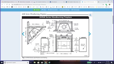

Can you find the rating plate identifying the unit? That can help us guide you...

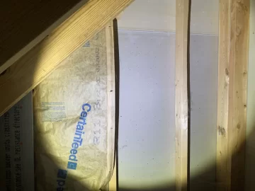

Is the wall BEHIND the fire box accessible?
Sort of. A staircase wraps around it. There is access under the stairs, behind a closet. It’s not terribly big.

I'd say it's not gonna be cheap. That particular model does not allow for a solid-fuel (woodburning) insert to be installed in the fire box.
You WILL hafta tear it out, along with whatever venting is in there as well. Depending on the type of cultured stone & how it's installed, you are probably gonna lose some of it. Getting a heart shop involved will give you ideas, but I bet when it's all said & done, you're gonna be over $10K USD. Here's how the unit is SUPPOSED to be framed in.
