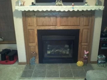

Grisu, THANK YOU for that list. It's incredibly helpful! To answer your question, I'm looking for something that should throw off enough heat to heat the house, or at the very least, to be our go-to heat source when the cold temps make our current heat pump an uneconomical option. While I may need some slight modifications to the framing, I'm confident that whatever we put in place of the TEMCO should not require a massive refit. The TEMCO is already framed up in the following rough dimensions:
Opening Height 34³⁄₄” (883 mm)
Opening Width 36” (914 mm)
Opening Depth 19¹⁄₂” (495 mm)
The box that has been framed in seems like it could easily accommodate a larger unit, so I think we're good there. I would also probably opt for some direct vent chimney system that would exhaust out the side of the house versus something like my current set-up, which exhausts up through the attic and out the roof. I really appreciate your suggestions. I'll poke around the pellet forums for their suggestions. Thank you.
So how big is your house and how well insulated? You could also post a floorplan.
Wood ZC fireplaces cannot be direct vented. You will need a chimney preferentially straight up to allow sufficient draft for full combustion and a clean burn.
Depth could be an issue. I think many units require more than that. You will also need to pull out the current insert to check the framing and clearance to walls inside. If your unit has been installed with minimum clearances only, you most likely will have to make some adjustments.
Thank Grisu-
I was not aware they couldn't be direct vented. That's important to know. As per size, the entire first floor is approximately 1,550 sq ft. (exact floor plan shown below) The house was built in 2007, so it's insulated up to recent code. 2x6 modular construction, R19 in the walls, R30 blown in the ceiling. As for the current framing, the actual framed space juts out 27.75 inches. Take off 3 inches for the 2x4 framing and another inch for sheetrock (both the outside and inside are rocked), you're looking at a good 23in of depth for the new unit.

23" is shallow. Most units are 24" deep. Would it be possible to install the fireplace flush with the exterior wall or partially into the room and enclose it in an insulated exterior chase?
