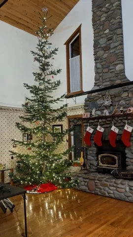

Everyone loves pics, right?

Every tube stove I have run has been set it and forget it. I think if you give the stove a real chance you will figure that out. Can you describe your install and operating procedures a bit?
Ok it looks like you have a decent height chimney. Does the liner run all the way to the top of the chimney? Is the liner insulated? Is there a block off plate installed?
Well, even if the stove is not ideal, the place looks gorgeous. The fireplace, however, looka like it really pinches back.
Thanks, we really love it. It's right by the river too. It's a real shame 90% of the neighbor's houses all burnt down on Labor Day. :(
Yes, it's sad, that is such a beautiful area. Silver Falls is one of our favorite OR parks to visit.
Finding the answers to these questions are probably my next steps. I haven't been on the roof yet. I'd imagine the liner goes to the top, but I question whether it's insulated. Although, I think that'd be more of an issue with creosote buildup than short burn times and lack of secondary burn performance right?
So you are burning in a setup which you really don't know anything about how it was installed?
