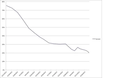

Back in early March a neighbor had a small elm taken down, and I took the opportunity to conduct a drying experiment. I oven-dried a sample slice, weighing it before and after, and established the initial moisture content at 76%. I also weighed a medium-sized split, and have continued weighing it every week or so, regularly calculating the average moisture content. Today that split of elm hit 20%.
[Hearth.com] American elm, fresh-cut to 20% in 103 days
This method is much more accurate than an electronic meter, but the result probably isn't typical; the split was sitting on top of a stack in a very sunny spot, only about three feet from a SE-facing brick wall that holds a lot of heat. Also, 20% is the average moisture content. It may be 10% on the outside and 27% in the middle, but overall it's 20%. For comparison I'm also tracking the drying of one split each of red oak, white oak and mulberry. None of those is ready to burn quite yet.

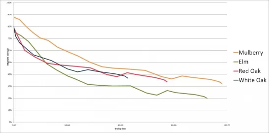

That's what I expect too, but it's been surprising how fast the oaks have lost moisture early in the process. The red oak dropped from 79% to 34% in 70 days, and the white oak went from 80% to 37% in just 47 days. The mulberry was wetter to start with (88%) and actually lost moisture a bit slower than the oaks, reaching 32% in 120 days. But the oaks' drying seems to be slowing while the mulberry keeps chugging down. I'm curious how the trends will look by the time the weather starts cooling off in the fall.
When I got the white oak, I put about a half a face cord of it in the rafters of my garage just to see what happens when the wood is kept warm (sun beats on the roof for several hours a day) but completely sheltered from both sun and breezes. That wood seems to be drying very quickly, but I neglected to weigh any of those splits so I can't get an accurate measurement.
Yeah, seems like the Oak slows to a crawl in the lower 20s. :mad:

What happened just prior to June 11th? Did it rain? (The graph upturn in MC)

What weight and rough dimensions is the split? What happened just prior to June 11th? Did it rain? (The graph upturn in MC)
The elm is a triangular split maybe 4" on a side and about 14" long. Initial weight was 3718g, and yesterday evening when it hit 20% it was at 2542g.
Yes, the leveling off starting around the beginning of may, and the subsequent zig-zags, are periods of rain and dry weather. It's been a wet spring.

One of the inherent challenges with my little comparison study is that the various trees weren't cut at the same time. Temperatures warmed considerably between the time the mulberry was cut (late February) and when the oak came down (early May). The best I can do is apply the rule of thumb that says wood dries twice as fast for every 20 degree (F) increase, so that a day in June counts for more "drying time" than a day in March, similar to the math I used here.
Doing that, the comparison so far looks like this:
