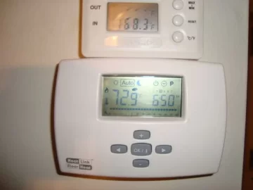

The temp hit -2 F last night in Northern Michigan and our house was COZY WARM (73 F with radiant floor heat) !!!!

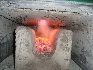

With the above settings I have been getting a nice blue flame in the secondary chamber and have not had problems with the wood " bridging" in the primary chamber. Also, I have been getting 7-8 hour burn times (as my tank temps get hotter my burns times are getting longer). I have noticed that the hotter the EKO runs the better it likes it.

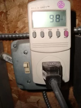

Power consumption of the EKO controller and primary circ. pump is 98 Watts (when I figure in my secondary circ. pumps I am using approx. 225 Watts.- which equates to approx. $22.50/month based on my current rate of 10 cents per KW/Hr).

Thanks for the info. I like the looks of your ash pit. I agree that the EKO likes to run hot. I generally get much better results overall at 190 than I did at 175.
