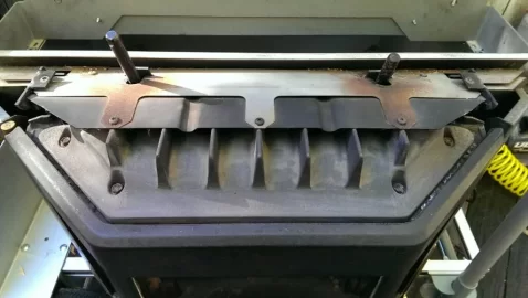

Do you guys remove the ribbed top cast iron plate when cleaning? If so, are there any caveats or precautions, or is it just a matter of removing those four bolts at top?
I've never removed that top plate on my stove. You do want to vacuum underneath that area inside the firebox when you clean. It tends to plug up with ash after a while.

Pull the housing out and scrape all the crap out of there. I remove The impeller off the motor and wire brush it gently. Its a REVERSE thread to take it off. I have never pulled the top of the heat exchanger off my stove. Seems the bolts are REALLY tight and I am afraid of breaking them off or stripping the threads out of the housing. That being said my stove is over 20 years old and as long as you clean that area well a couple times a year there should be no reason to remove it.
