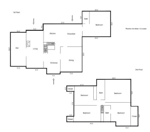

If you can use a fan to move cooler air into the room, post a sketch of the 1st floor plan for guidance on which doorway to put the fan near.

Here is floor plan:
[Hearth.com] Another Jotul Oslo vs Castine Post: How to Size the Stove.
A stud cavity fan on the common wall with the kitchen would help increase circulation to the main part of the house. If that is not an option, then a fan on the floor of the den blowing into the living room would be the next thing I would try. It's the easiest location to experiment with and stay out of major traffic.
It looks like a nice stove in the large entry hallway would be the most effective heating location.

We have to work with the current hearth location.
We had the den closed off with a door during last winter, but I guess I could open the door as an escape valve for excess heat.
Would the absolute best place for the fan be between the living room and the entry way?
After looking at this floor plan, do you or others still think the Olso or Castine is too much stove??

If you are just heating the room, the Castine will be loafing. It may not have an overnight burn time, but it is a very capable heater. If you like to keep the den closed in winter, a very good solution would be to put the fan in the dining room entry way and blow it through and into the living room. How much do you use the dining room? If only when there's company, this could be a nice solution. It would help circulate heat into the house.
What is on the kitchen wall that is in common with the living room? That also could present a neat, built-in fan solution that may have higher WAF.

I actually broke through that wall and put in a doorway between the kitchen and the living room. It doesn't show that on the plans.
