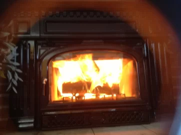

Really, I have 1 room that consists of a family room where we watch tv and a table where we eat dinner, a total of 550 ft with its own oil heating zone. We put an insert into the fireplace in February and now we couldn't be any happier, we would never even consider putting a freestanding stove in front of a fireplace, but that is our preference. I don't need a house heater, I needed something to heat the 550 that I have. What may I ask is wrong with that? I didn't buy an Oslo, I got a montpelier. So for me I think I did the right thing.... What would make you think I didn't? Just asking, your comment doesn't jive with my situation yet you seem to me that you are in this profession of stoves. I bought and I'm happy, so I'm ok.......

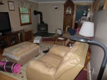

Not sure if this helps or not, but my Oslo sits in the corner of my living room which is 281.25 square feet (12 1/2 feet x 22 1/2 feet). House is a 1976 two story Cape with moderate insulation. I live in Maine. Total size of the house is around 1,800 square feet. The Oslo is my main heat source . . . I haven't filled the oil tank since 2008 . . . although I'm thinking of filling it up this year as I do use some oil when I am away on vacation in the winter, when it's extremely cold outside, etc.
The living room with the stove does get warm . . . then again . . . since I am just sitting there watching TV or reading and not moving I like it warm. You get used to the heat in fact. Regular temps are in the mid to high 70s . . . as I said, you often get used to that heat. My own chair is about 8-10 feet from the stove. I cannot tell you how often I have fallen asleep in that chair while just staring at the fire. As you move out the temps drop a few degrees. In the adjacent dining room the temps are typically in the mid-70s. Upstairs bedrooms are around the same temp. Temp in the master bedroom is one of the cooler rooms -- not sure of the exact temp, but I would guess it is in the low to mid-60s.
I do use a fan to move the air through the home by pushing the air towards the stove. I'm not sure if you would classify the house as open or closed . . . the living room has two entries and we don't shut doors in the house, but it's not a wide open living space either.

Thanks for posting that Jake. It's most helpful guidance. The OP is in a bit warmer climate zone, but now that we know the room has 3 openings I'm going to reverse course and agree that the Oslo can work as long as a fan is helping move the air. A nice looking insert like the Jotul C450 would also do the job. Moving air through the room will be the key to keeping the area comfortable.
