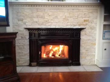

I can only say.... I love my VC, if you go this route, this probably will not heat your entire downstairs, I am heating 550 sq ft, one big room with many windows and no insulation. I did find out, I was able to heat an additional room, the kitchen, when it got to over 40 degrees out.......
That being said, it will stop your current fireplace from sucking out warm air, it will heat the room that it is in(space heater) and it will look great, so it is worth considering for sure..... Good luck [Hearth.com] Another newbie looking for advice
