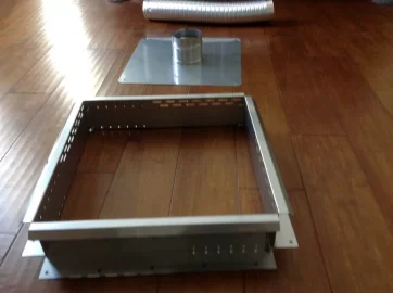

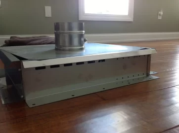

I plan to do this next week if the weather cooperates! I will post some pics of the parts in the next day or 2. I want to make sure I have everything before I start anyway.
I have a full liner in the chimney so my exhaust terminates at the chimney cap. My cap is currently sealed tight to the top of the chimney. I will take that off and put the Harman piece on. The Harman piece is a louvered spacer that raises the cap about 4 inches. That allows outside air into the chimney interior. The stove exhaust is inside the liner, the fresh air (oak air) surrounds it. My OAK pipe will run from the stove past the block off plate and into the chimney a few feet. So it will pull air from the chimney cavity while the exhaust runs right by (in the liner).

Hope the pics help! [Hearth.com] Another OAK question [Hearth.com] Another OAK question
Both venting and OAK side by each to the top of the chimney. Both through the chimney plate on top. Vent goes up another 4 to 6 inches with cap and the OAK (flex pipe) bends downward away from venting about 2 feet. That's almost 3' away from each other when the manual for my quad calls for 12". That's how mine is.

Hope the pics help!View attachment 88252 View attachment 88253
How far is it from the vent holes to the top of the cap? Aren't you concerned about sucking the exhaust through the OAK vent holes? See my pic above for min specs on my stove. I would think they would be close to the same.
Edit: I just looked at your manual and it looks like the flex pipe extends a distance above the OAK spacer so by looks it should be no worries.
