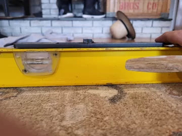

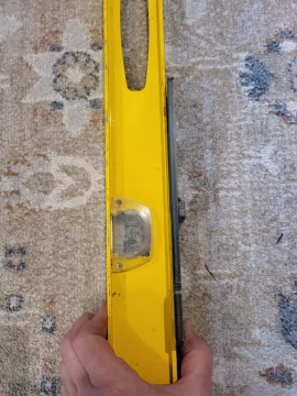

They came today and replaced the manifold and air control valve. A little early then expected so i was pleased with that. Both these parts were from the display model because Jotul is not shipping them until the end of March. I checked the new control valve for bowing before they put it in and this one was slightly bowed too (pic attached) obviously not as bad as the first but sill a slight bowing. I tried straightening this one like the other and it straightened out pretty good. I had the installer put that one in but I asked the shop to let me know when the other is in so they can see if that one is straight.
I find it bizarre that 2 out 2 stoves have a bent vavle. I'm wondering if this is a consistent issue with these stoves. It seems when they weld the stop on the valve its causing the valve to bow.

Did they burn the display model at the shop? Maybe the heat from the fire is causing this to bow?
