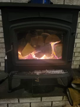

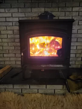

1st load was red oak, locust, ash and cherry. 7 logs not filling the whole fire box, pic attached. Splits are 4-6 inches so decent size.
2nd load was the same mixture of hardwood but 8 logs. Packed pretty tight but not jammed full.

This stove has a third larger fuel capacity. That has the potential to create significantly more rapid outgassing of the wood load when it's placed on a hot coal bed. Try turning down the air much more aggressively as the wood catches fire.
Turn down the air sooner and pack it tight. It’s way easier to to close it too soon and loose the flames and open it back up. Than it is to sit there looking at a raging inferno with air closed and see the temps still climbing. Ask me how I know. 😉
New stove, it will take some trial and error to figure her out.
Reactions: bigealta

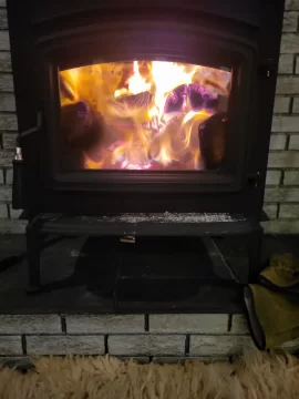

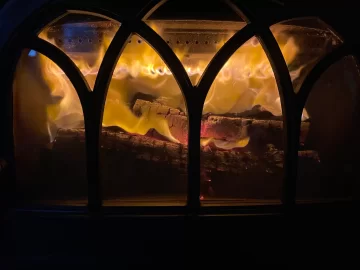

550 STT is a good reasonable cruising temp.
I go by the secondary burn visual thru the door.
Always shooting for a good solid amount of secondary "jet" flames, with minimal amount of flames down by the splits.
So good rolling fire at the top of the firebox (over top of the load) with very little "fire" on the load.
If you can get that dialed in you'd be running the stove in an ideal way.
Starting with the 1st pic and trying to get to the 3rd pic and cruise there if you can.

I still haven't gotten where I just have flames at the top. That would happen a lot with the true north but I had to have the the wood packed right under the tubes.
I haven't stuffed the f55 this full yet so maybe that is why. So far, secondaries in the f55 have been accompanied by flames ripping off the logs pretty intensely

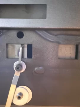

Here is a pic of the underside. This is with air control all the way closed. Still seems like some pretty big gaps even with air all the way closed.
I'm assuming you are referring to the little whole toward the back?
In regards to the glass and door gasket. I have not really had any soot on the glass yet. It has kept quite clean. The dollar bill test seemed to do ok. It did not just slip out.
Should that air control "door" still have that much gap with it all the way closed?
Thanks!
  • [Hearth.com] New jotul f55 v2 questions
Reactions: begreen and Todd
Try placing a magnet over that round hole. I believe that is the unrestricted boost air that comes into the lower front of the firebox under the glass. That may give you a bit more control.
Beat me to it but yes, that is the boost air hole. Covering that with a magnet or metal tape may be all that's needed to tame the beast.
Yes, there needs to be some minimum air for the air wash and so that the fire doesn't smolder. Thanks for posting the pictures!

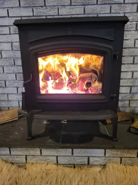

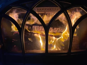

Loaded off a bed of coals from my 3:00 fire at 9. Stt was just under 200° but I had a pretty good coal bed so I tried just loading with air closed all the way (1st pic). It lazily build up but never really took off so i opened the air control a tiny bit at about 35 minutes. And closed the air again after about 1 minute (pic 2). This had stt at about 550°,and flue at 250° where I can measure.
The temp never really rose more at the one hour mark so i opened the air again just a tiny bit for about 1 minute and then I closed it again. Temps rose steadily now and I've maxed out at 770°stt and 322° flue temp(3rd pic).
Its cruising now at this intense level. Blower is turned up on high.
I'm just amazed at how this thing shoots up in flame intensity and temp by moving the air control less 1/2 an inch for about 1 minute.
I was uncomfortable leaving the air all the way closed from the beginning because of the creosote potential but maybe I should have?
Not comfortable with this temp it shoots up to.

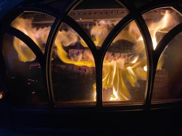

Well... actually climbed to 794°... not cool. So i went ahead and grabbed a magnet and covered the hole.
Temp is falling now but not sure if that's the magnet or just the burn is winding down.
This is at the 1.5 hour mark of this burn.
The right side is burning hotter but that may be because I had a really dry piece of cherry and locust on that side. But the door is measuring hotter on the right side too, in the 700's.
Is this pointing to anything that could be wrong?
It's ok, we all go through a process of learning a new stove's personality. It takes a month or so of burning under different conditions and with different wood loads to see what she will do. Eventually it will be more routine. I think you will find the stove a bit more predictable with the boost air hole closed. That helps with startups, but if one has dry wood and loads N/S, then startups are usually easy with a bit of kindling, even with the boost air hole blocked. It is on our stove too.
You’re learning to walk that fine line. Waiting as little as two minutes to turn down can make a huge difference on max temps. A reload on hot coals is hard to control. I like to use kindling to get a fast but not hot flame. Some on the bottom. A couple sticks on the top. The faster I can get a fire the faster I can turn the air way down.
Rake the coals all to one side for a N/S load or front or back for E/W. I’ve not tried back. But the logic is that they only touch one or two splits so the whole load doesn’t start off gassing at the same time.
Reactions: bigealta
Very little moves with the draft in the f400 can dramatically change how the fire burns. My situation is tiny moves can stall the flames vs your situation where you are trying to control vigorous flames.
I'm adjusting in the 1/2 open to 1/4 open range with tiny adjustments within that range. I have a short chimney.
With you adjusting at closed and just above, you must have to much air feeding the fire.
The magnet is the best place to start. See how much it helps. If you still need more air restriction you could probably get an additional magnet that can partially block the rectangular opening (below the round hole) where the air slider is. Just make sure you don't block the slider from freely moving.
