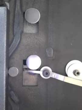

I just looked at your air flow diagram in the manual. That round hole underneath that it thought was the boost air may be the secondary air inlet? I was thinking it was similar to my F45 but it’s not, my secondary air came in a slot in the back yours looks like it comes through the front? You may have blocked off your secondary air and that’s why you’re seeing smoke? You may have to block off the boost air from inside the fire box instead? Sorry about that. Are there any other holes under there you can see? Maybe the bottom heat shield is blocking access?
Here is another pic of the underside. Maybe it can provide some guidance. My air control is all the way closed on the pic and hopefully u can see the magnet covering the circular hole.
There is nothing in the manual about boost air and when I uncover the hole my magnet is currently covering u could hear the air rushing in. Sounds like a faint blow torch.
I definitely have a little more control with the small hole covered. Each time its been uncovered, stove has reached upper 700° to 800's.
What is that big rectangle hole in the heatshield in the pic? I'm thinking this rectangle is the secondary air per the diagram and the description under "how your jotul f55 v2 works" section in the manual.
My paint is starting to flake in places. I don't have the rear shroud/heatshield on since its its a fireplace mount but Im starting to see some flaking/peeling in the back as well as other spots. Its weird, I woikd think the top works be flaking because of the STT ive reached but its in places that do not get as hot. I did the 3 break in fires.
Thanks!
That’s my guess the big rectangle is the unregulated secondary air. Try a magnet over 20-30% of it. I tried block off my secondary intake before the damper. I couldn’t get the balance correct. I had to pull the blower and reach back several inches. Impossible on a hot stove to do with any precision.
I still think we haven’t uncover The root cause yet. Blocking air works though
Better solution. Add this outside air intake and make a blast door air control.
That big rectangle looks too large for secondary air but I don’t know what else that could be. Could it be part of the bottom heat shield? Maybe there’s another hole near that underneath hiding? Are you still seeing secondary burn with that round hole covered? If it were my stove I’d be tearing it apart to find out how it works 😂

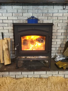

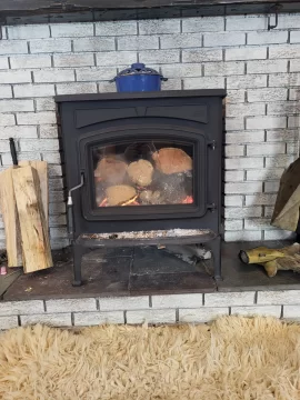

Had my second load today. First was small because my son had a soccer game and im not comfortable loading up and leaving yet.
Jotul manual says rake coals evenly throughout firebox so I tried that vs raking to front.
Unfortunately it really didn't help. I had the air control closed completely in under 10 minutes with Stt around 400° and flue where I can measure between 280-300°.
At the 45 minute mark I was hovering at 690° so I applied another magnet. Temp climbed more to 733° max so i applied another magnet. Attached is a pic of all 3 magnets applied as well as my load at 45 minutes. I may be wrong but these flames were not lazy but ripping. Also, I feel my splits are quite large too and the one in the center top is an unsplit red oak round. Maybe my issue is that I am using smaller splits on the bottom? But the smaller splits are black locust which is harder to burn. My logic with smaller on bottom is to avoid too much smoke and faster light on a coal bed start up. I attached a Pic of it loaded as well to hopefully show split size.
I'm at an hour and temp had settled to 650° so I didn't hang out in the 700's long but I would rather not even hit that. This is a bigger stove and produced good heat at 550°-650° range even in single digits. I'm measuring with infrared thermoter. The closed i am to the stove with it, the hotter it reads.
I will try bigger splits on the coal bed next time to see if that helps but feel having 3 magnets to cover holes is a little unreasonable.
Also, tried seeing if smoke entered anywhere around the stove and smoke was only entering the air controls on the bottom.
Hopefully someone can see something I may be missing.
Thanks!
Edited to add 4th pic at 80 minute mark. These flames seems lazier and 3 magnets still applied
