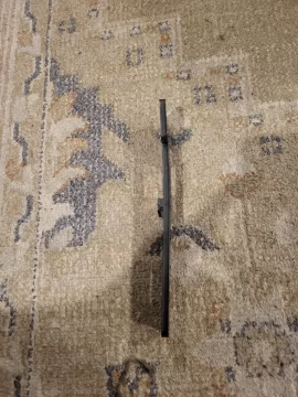

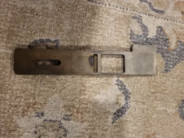

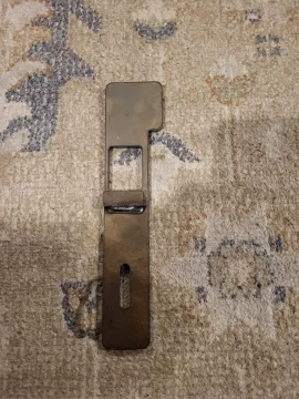

Ok can you take a few more pics of the piece? Can u tell if is cast or just mild steel?
Here's a couple more pics...
Not sure what is made of. Is there a way to tell?
I tried searching online for a replacement part via the part number in the owners manual (#158214) but im coming up empty handed.

Do you think it’s limiting travel
Reactions: Todd and bigealta
Shoot i can't say for sure from pics. I too looked for the Part earlier today and no one had it.
So let's no break it. I wonder if that weld bent the piece?
Maybe someone else will know if it's cast. If no answers then you have the choice to reinstall it as is and put those magnets back.
You have the pics to show it's jacked up. I bet it will take a while to get a replacement unless the stove seller will pull one out of his floor model.
I think i'd wait just a bit to see if anyone chimes in. Then i'd put it back and just maybe do smaller loads.
In fact with this cold snap i'd put it back now. And get a mid sized fire going.
The only fix option is to try to bend it back.
If mild steel i'd do it, but if cast absolutely not, it will break. There is a good chance it's cast.
you can always do it tomorrow or in the next couple days.

My money says the problem has been found!
Anxiously waiting for the results.
I think its allowing air in since it is not seated flat against the base of the stove.
I'm assuming this is what is causing my stove to be difficult to control.
That looks like the proper diagnosis. This is a factory defect. It should be a warranty item.

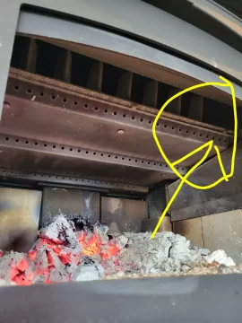

I noticed the baffle is bending up a little and hopefully you can see this in the picture. The seller asked for pics of the firebox which im glad they did and they are addressing this too as it seems a little warped.
My question is, what are the performance consequences of this damage? The only thing ive noticed is the right side gets hotter faster but don't know if the two are related. Still getting good heat and flame time is still about 3-3.5 hours and I have decent coals in the morning.
Hopefully you can share some thoughts on this.

It does look like it is bending up a bit, is it tight like it looks like on the left side and in the middle? Hard to see for sure in pics?
How is the stove running now compared to when the slider was bent? Are you getting flame control without having to have the draft fully closed?
Reactions: Todd
Yes, its bent up on the one side where it is circled. I wasn't super concerned nut i don't like that is seens warped.
Could this effect performance?

Is secondary air entering the firebox along what looks like an open seam?
