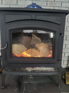

I seem to be settled on 3 loads a day. My afternoon load went pretty well. I loaded some pretty big splits (pic below). Loaded at about half throttle and turned down from there. Secondaries kicked in pretty quick but stove and flue temp were still low but went outside and didn't see any smoke. Climbed to about 660° stt max. Right side still seems to hotter then left.
I can try this e/w load but I think it will be good for my afternoon load. Thats the one with the shortest time in between loads so since its just 3 splits the coals should last.
My coals are starting to last longer. I'm assuming that's because my ash bed is getting deeper but maybe the magnet over the hole is helping too.
Just out of curiosity, if your think im gonna need a 2nd magnet, is this a malfunction with the stove or just the way it is?
It sounds like the boost air block is acting as expected. Ours has been taped over for more than a decade.
I would continue to run it with the boost air blocked and see how it goes for the next week or so. Tweak your air adjustments to find your sweet spot. There are a lot of variables in wood burning and every fire can be a little different. It sounds like you’re getting the hang of it.
Many stoves have this unregulated boost air shooting straight into the lower firebox like a blow torch. Many installs especially with stronger draft really don’t need this extra air. The air that feeds your secondary baffle is also unregulated and can sometimes be too strong.

Tried this e/w load this afternoon and it did no go well. Took a long time to get started and had to add some kindling and newspaper to help. It may be because the majority of the load was black locust packed super tight. I had to remove the magnet on the secondary air also toget it going. You can really hear the air (faint roar) when the magnet is removed. Had to add an old piece of ash and hickory to finally get it to take off and close th eair all the way. May be checking my chimney later... lol.
I'll need to try it again with more of a mixed load but things seem better controlled with the magnet in place and loading n/s. Didn't have to shut it down so fast this morning but more in increments like i did with my truenorth
The good news is f55 can take 20 inch logs e/w so when I come across some of those, I won't need to shorten but just set aside for that specific load.

So u went from 1 extreme to the other.
Yes Locust is a hard starter and needs more air and a looser spacing. I've been burning 4 year old locust for the last couple weeks and it takes more air and for longer than any other wood. But then in the middle of the burn it can get Very Hot. It can take an hour or more to get there. Definitely mix in some easier burning wood to help it get going.
If i knew you were going to load with all locust i would have suggested to put spacers between the bottom and top rows and to put a couple easier burning splits (pine, maple, ash, even oak) mixed in.
At least now you know that your stove will not always run away and is controllable.
If you are getting control of N/S loads than that's ideal. If not then E/W is a tool to get the control back.
