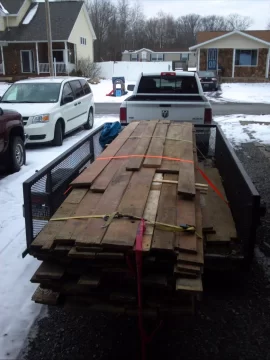

Well, with all the work I put into the stonework, ceiling and such, I wanted a special floor that matched the old, colonial style that was in that room. So the search began for antique flooring......and some of that stuff can be MEGA expensive.
I fould some local chestnut boards that were milled from antique salvaged barn beams and after it was tongue and grooved worked out to be around $16.00 per square foot!!
That room, being 550 sq ft, would have blown my entire budget...and that's BEFORE I even had it sanded and finished! So I kept looking on Craigslist and eventually, after 6 weeks of relentless searching, found a guy that disassembled old cabins, barns, and homesteads who had basically what I was looking for. He had torn down an 1830's farmhouse near Daniel Boone's homestead in the Oley Valley, near Fleetwood, PA. He had around 700 sq ft of antique old-growth fir flooring from that farmhouse, and I haggled with him and got a great deal on the wood. Yes, fir is a softer wood, and yes it will ding and dent over the years......but its authentic to the era that we were trying to replicate......and it is a warm, beautiful wood when finished correctly. It was over 1" thick, was in various widths from 3" up to 8", and had antique hand-planed tongue and grooves. The wood was worn, the T&G's were broken, but the boards were worth salvaging. When my wife and I made the 2 1/2 hr drive to get the wood, and she laid her eyes on it, she wasn't real happy......it looked rough to her. But to my eyes I could see the hidden beauty in it. I told her to trust me, that it would make a warm, beautiful floor in that hearthroom. She reluctantly accepted......
We brought the wood home and the real work began......taking all of those broken and rusted-off hand forged nails out of the wood. I had over 9 FRIGGING HOURS in that job, using a metal detector to help verify I got all the nails. After that, I had an Amish shop over the mountain from our house plane all the boards down, and put new T&G's in them for me........then, the next issue surfaced. The Amish shop had the tooling to T&G the long sides of the boards, but NOT the ends! So I had to make a jig and use my routers with T&G router bits on EVERY SINGLE END OF EVERY SINGLE BOARD!!
Actually, once I figured out a jig, it went pretty smoothly. I ended up cutting a lot of bad sections out of the boards, but still the majority of the boards were in good condition. I liked the antique square nail holes on the wood, and I ended up filling them with black epoxy and sanding it smooth......those nail holes REALLY give the wood character!
After getting all the wood installed, I filled the old nail holes with black colored filler (as mentioned above), rented an orbital flooring sander for Memorial Day weekend, and went to town. Almost 9 hours of sanding and it looked smooth and beautiful! We opted for Minwax Early American stain, and Varathane Satin finish.

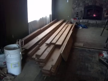

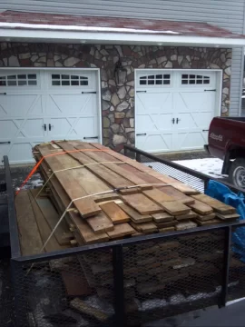

Pics of wood when we brought it home........not much to look at!!
[Hearth.com] Antique fir flooring.....hard work, but worth it in the end! [Hearth.com] Antique fir flooring.....hard work, but worth it in the end!

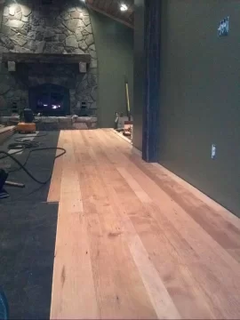

The amount of wood REALLY shrank after it was planed and new T&G's were milled into it.....second and third pics are of the section of subfloor I replaced. The hearthroom is a combination of two rooms, the original living room from 1918 and a bedroom that was added on in the 1930's). I wanted a perfect transition between those two rooms...
[Hearth.com] Antique fir flooring.....hard work, but worth it in the end! [Hearth.com] Antique fir flooring.....hard work, but worth it in the end! [Hearth.com] Antique fir flooring.....hard work, but worth it in the end!

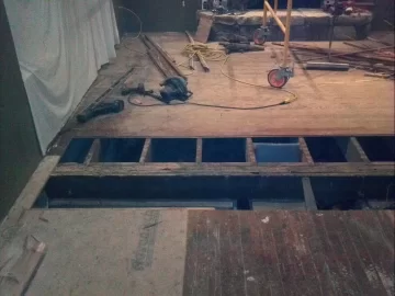

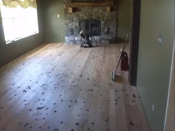

After the subfloor was repaired, felt paper for a vapor barrier was installed and the floor began to go down!

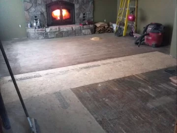

After all the floor was installed, I filled all the antique nail holes with the black wood filler. Took two evenings just to fill those holes!! Then, 9 hours of sanding later, the floor was ready for a good cleaning and stain!

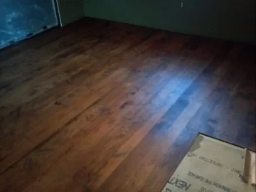

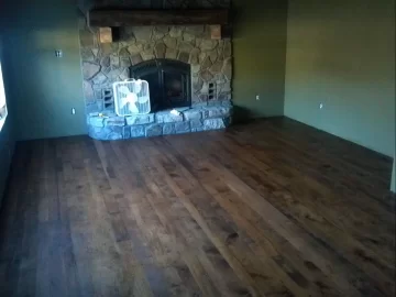

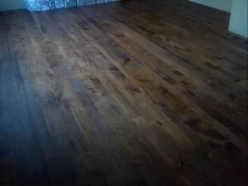

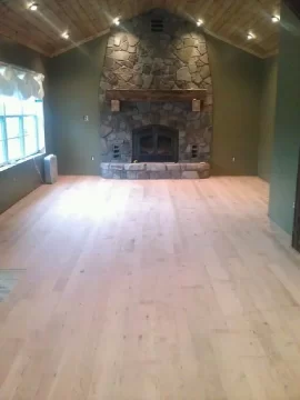

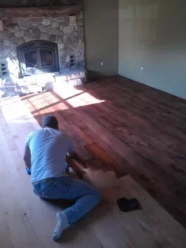

We stained the floor the other evening. Minwax Early American ......looks wonderful! Really brings the hues of the wood out! Then, after it dried for 24hrs, the first coat of Varathane satin went down. That REALLY brought the character out of the wood! I still have three coats to put down over the weekend, then it's full steam ahead with the slate in the entryway and the oak colonial trim!!
[Hearth.com] Antique fir flooring.....hard work, but worth it in the end! [Hearth.com] Antique fir flooring.....hard work, but worth it in the end! [Hearth.com] Antique fir flooring.....hard work, but worth it in the end! [Hearth.com] Antique fir flooring.....hard work, but worth it in the end!
Wife is TOTALLY in love with the floor, and I gotta admit, I am too! The long and short mix of boards, coupled with the varying widths (2 1/4" up to 6 1/2") REALLY set the floor off! I think it compliments the fireplace nicely. Its hard to believe this flooring is almost 200 years old.......

thanks, PD And Charly.....
I used a staining sponge (around 3"x4") to put the stain down. Yes, it took several hours as it was a two step process. Wifey worked ahead of me with a spray bottle of water and a sponge. I did some research and found the best way to stain pine or fir is to moisten the wood to get the pores to "open up", then once the water is more or less gone, put the stain down. It worked, you can REALLY see the different grains and patterns in the wood. Varathane is a little tricky to catch onto (poly isn't easy, either), but the Varathane, being water-based, looks like skim milk when you are putting it down. In one way, it's nice because you can see where you already put it down and you aren't constantly overlapping your previous work. It's also nice because it don't smell NEARLY as bad as poly.
I just finished up the second coat, I'm going to try and put down the third coat late this evening if I can. Then, I'll wait and put the fourth coat on tomorrow afternoon. Sunday morning, I'll scuff it with a Scotch Brite pad, go over the whole floor with the sweeper and a tack cloth, and then and put the fifth and final coat on Sunday afternoon.

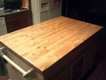

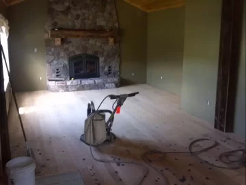

I almost forgot......since we had the sander for the three-day weekend, wifey wondered if we could use it for the butcher block top on our kitchen island. The top is 3' x 5' x 2 1/2" thick. I took the top off, took it out on the deck and in 10 minutes the job was done. Three coats of butcher block sealant (food safe), and its never EVER looked so good!
