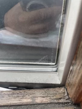

Note: Pics 15-16 shows the product ID and the phone # inside top window jam for ordering parts. The type of window glass is etched on each pane in the lower right corner for ordering new glass.
