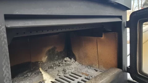

I wouldn’t cut it. The air wash goes down the face of the glass, so I would assume it is needed to direct the air downward. It bends easily, it’s not case hardened or the like, so just bending it works, plus you don’t ruin anything by cutting. Looking at mine, you can’t tell anything was done to fix it.

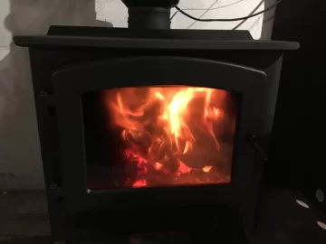

Up until two days ago I would have said don't bother, but @grog18b 's tip on bending the air wash sorted me out. Overnight, it's like a different stove! Burning really well now.

You are welcome. The entire reason I joined this forum was for this thread. I saw someone having the exact same problem I had with my 32. Both my stove and flue are brand new and built to specs. My wood is properly seasoned and dry. Before I bent that ledge out of the way, my stove would not work at all with the door closed and latched. I added an external air source in an attempt to get mine to work. It did not help at all. It was obvious there was something wrong with the path of the main air supply. After bending this ledge out of the way, my stove works perfectly.

QC slipped. That should never had made it out of the factory. I hate to see this, but it has been more frequent in the past few years. I'm glad you could get it sorted out. It's a good value stove.

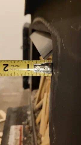

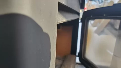

So I figured I'd better compare my 32NC. And yup, it's different too, it sticks out almost a half inch (camera angle isn't totally straight so it looks like it's less), BUT only on the side with the latch. The hinge side is a lot closer, maybe 1/4".
I think they probably need a better jig for when they weld the air wash plate in.
Should I mess with it or leave it alone?

I would say if yours is working, then leave it. When I was “adjusting” mine, the window was still getting dirty, until I got it to the photo I posted earlier.

Just took a closer look at my Peasant Hearth 2200. My air wash and intake control are directly above the door, no mystery there.
But it is very similar to your Englander stove in relationship to the glass.
My clearance between the angled lip and glass looks to be about 1/4" with the door closed.

Based on @grog18b 's advice, the Englander has been burning properly for three days, now, and we love it. It doesn't require much "fiddling with." Just load the fuel onto the hot coals, let it catch, choke the primary air to secondary burn, and come back hours later to "rinse and repeat." Overnights are good for 9 or 10 hours depending on how much we stuff into it--getting best overnights with unsplit, seasoned logs. Lots of hot coals in the morning for rekindling. Plus, my wife loves being able to see the fire--I think we'll keep her--the stove, that is.
