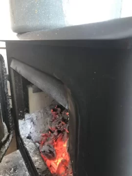

I see the metal lip you're referring to... it's at a 45° angle from the top of the stove, and comes out at least an inch or so from the actual firebox. I had a devil of a time--even with a flexible endoscope--trying to trace where the primary air comes into the stove. I never was able to find the path. If this is it, it would explain an awful lot about what I'm experiencing with this thing. The metal airwash lip on my stove doesn't quite touch the door frame, but it comes darn close. I'm guessing this is what they did when the eliminated the "doghouse" from the previous versions of the stove?
I don't suppose you could snap a pic or two of how the airwash lip on your stove looks now? So I can get an idea what I'm shooting for? Really appreciate your help!

I guess I bent mine down further than I thought. I went a bit at a time so it was hard to judge exactly how far. I think if you took a wood yardstick or similar, and lay it across the front of the stove, you can use it for a guide to keep the lip straight. That and the wood yard sticks are about 1/8” thick.
Most of the EPA (tube) stoves dump the primary air at the top of the door like that...

I studied the problem tracing the air flow.
Grog-
So I stuck my flexcam above that airwash lip, and it seems that the air comes from either side of that lip, from two rectangular passages that run down on either side of the door, at the front of the firebox. Couldn't manipulate the camera any further, but I assume those two rectangular passages make their way to the primary air intake in the back of the stove. Does that sound similar to what you found?

I answered you earlier but my posts need mod approval... if you try this, your stove will work great, and you won’t need further repairs or a replacement. If that lip is sticking out that far, I can guarantee that is your problem, and you can try your stove out tonight.

The pipe wrench I used didn't mar the surface at all. The steel bent easy, but if you are concerned, you could use a rag to cover the jaws or sandwich it between two large popsicle sticks against the jaws. I’m confident this will fix your problem, but you can always bend the steel back. That’s why I gave this fix a try, as I paid quite a bit for the stove, and, as it was, it was useless. I’ve used it the whole season so far. Let me know how it goes.

The 32 is not like the 30. The plate we are talking about is not thin.
You are welcome. The entire reason I joined this forum was for this thread. I saw someone having the exact same problem I had with my 32. Both my stove and flue are brand new and built to specs. My wood is properly seasoned and dry. Before I bent that ledge out of the way, my stove would not work at all with the door closed and latched. I added an external air source in an attempt to get mine to work. It did not help at all. It was obvious there was something wrong with the path of the main air supply. After bending this ledge out of the way, my stove works perfectly.

Middle of the night, stove temp 525. The air wash plate on mine is the same thickness as the steel on top of the stove.

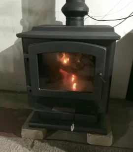

OK, looks like we have a wood stove, here...
This is the firebox with three, very small splits--just above kindling size--and it's been burning with the door completely closed for over 30 mins! It may not look like much, but it's the first time the stove has burned for more than 5 mins with the door closed.
Thanks to @grog18b for his air wash bending tip--I think we're onto something!
