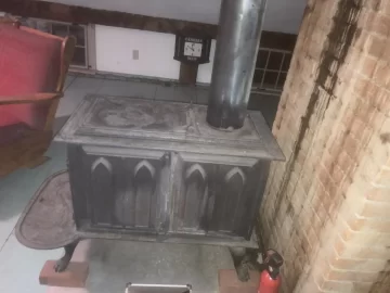

They rarely are air tight and intended to put out a lot of heat in short period but without any baffles in them a lot of the heat goes right up the stack which is sometimes a benefit with green wood as the stack temp stays high enough that the smoke does not condense
A liner the same size as stove outlet would increase efficiency and insulation around it (minimum 1 inch blanket) is needed for safety. (Measuring inside area vs. exterior will give wall thickness. This needs to be 12 inches solid masonry if no clearance to framing members) Notice the fluid that leaked out and ran down the outside of chimney. The inside is much worse.High heat in a short amount of time is exactly what I need in this particular space. There is no other heat source and it is normally left cold. I would just run the stove occasionally when hanging out in there.... and then let it burn out.
I have a similar unsealed (by design) morning stove in the kitchen, which is much smaller. My experience with it is as you say: High heat, quick heat, tolerates green wood, functions amazingly well with good wood, the stove pipe gets hot, not much buildup/creosote. It certainly does eat wood quickly.... but it is puts out a corresponding amount of heat.

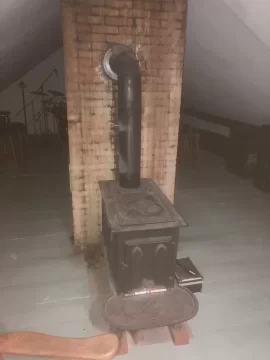

The big attic stove (the one in the photo) goes into an unlined chimney. That would probably be a disaster with a modern stove, but I have heard that the stove used to function well. I thought of doing a round liner, but I wonder if it would increase performance, if there are not draft issues to begin with.
Yes I see what you mean about cooling that occurs by going into such a large chimney. The stove pipe enters the chimney almost at the roof line... so I am trying to justify it in my head that way. The smoke is not travelling very far. I have not tried the stove. The stains are from previous owners.A liner the same size as stove outlet would increase efficiency and insulation around it (minimum 1 inch blanket) is needed for safety. (Measuring inside area vs. exterior will give wall thickness. This needs to be 12 inches solid masonry if no clearance to framing members) Notice the fluid that leaked out and ran down the outside of chimney. The inside is much worse.
The issue is the hot exhaust gasses are allowed to expand in the larger area. This drops them below condensing point of 250*f. You need to measure the actual flue area this is using. That’s why it is against code to use a flue 3 times the size as stove outlet. Then you will know how much expansion and cooling you have.
The fluid is pyroligeneous acid. Primarily methanol (wood alcohol) and acetic acid. In fluid form, from condensing of water vapor from combustion, mixing with smoke particles, this is harmless. When allowed to bake in chimney it becomes creosote. If this ignites in that chimney with no liner, probably less than required clearance to framing members, it will ignite easily since the heat from that chimney over the years has lowered the ignition temperature of material around it.
Oops, I meant to say that the liner looks better, but a separate insulated metal chimney pipe through the room would free up the masonry chimney for other uses (fireplace and brick oven). In the past they had everything dumping into it. It is not as bad as you might imagine. Also, I can access all of the masonry from the outside. So I could repoint or repair any bricks. I did a test and not finding any smoke leakage. I am going to do some more measurements with instruments.Yes I see what you mean about cooling that occurs by going into such a large chimney. The stove pipe enters the chimney almost at the roof line... so I am trying to justify it in my head that way. The smoke is not travelling very far. I have not tried the stove. The stains are from previous owners.
I am not sure if I want to do a liner (looks better, and frees up the chimney for other uses) or an insulated metal chimney pipe straight out of the roof. It is a short distance. My hesitation involves cutting a hole in the metal roof, which may be more difficult.
Perhaps I will do a small monitored fire in it to test it. I will then at least have a frame of reference for how it performs when I put the round liner (or chimney) on it. I will feel much better mentally if it ends up performing better.... or at least the same, while being safer.

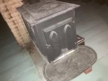

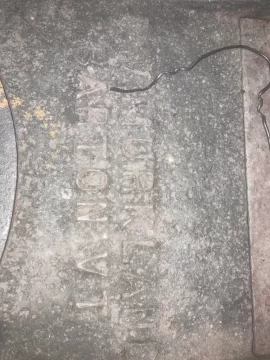

Does Barton VT have a history of a foundry?I wonder if it was poured elsewhere and made for a specific vendor.
Love them Elm stoves in your avatar.Yes there were stoves in Barton, I have seen a few of these. Barton is the next town over and ive been meaning to get over to the town clerk and do some digging. Ill update the thread with what I learn.

Cool.Does Barton VT have a history of a foundry?
Near here is Iron Ridge and Mayville, WI. Interesting history of iron ore, a stove, and a town.
Mayville Iron Parlor Stove | Wisconsin Historical Society
Gothic revival parlor stove made of iron ore from Mayville, Wisconsin, 1846. (Museum object #1999.141.1)www.wisconsinhistory.org
![[Hearth.com] Antique stove from Barton, Vermont ?? [Hearth.com] Antique stove from Barton, Vermont ??](https://www.hearth.com/talk/data/attachments/291/291031-0d415ec8ac5b18b160a433b9e92585c0.jpg?hash=KpUAi4lmTC)
