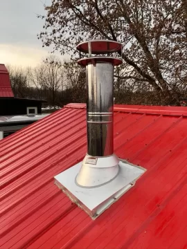

The hole for the chimney pipe gets cut ahead of time, but the flashing boot goes on after the roof is down. There are flashings meant for metal seam roofs. This picture shows ICC Excel which is often used.

Metal flashing made for metal excell and ventis make ones. And if your roofer wants it down first find a new roofer

Question: I just installed an Excel flashing (like the one in begreen's image) and am happy with it. However, I might kind of understand what the roofer is asking here. If the chimney pipe was present and the flashing was simply slipped over it (but not screwed down etc.), wouldn't that allow him to easily drape the upper panels over the flashing and avoid the necessity of having to cut the ~23" wide x 1/8" slot (as per the Excel instructions) through those panels to slide the top edge of the flashing through them?
That was the only part of the install that was problematic for me. I just want to be sure I understand what you more experienced folks are thinking in case I ever have to do this again!
Do you really seal the bottom like the pic shows? Seems you would want to give water a way out from under that thing.
Reactions: stoveliker
I never do. You want water even if just from condensation to have a way out
Reactions: Highbeam
I sealed the lower edge of mine because it’s pretty far down the roof and I was worried about ice creep getting back under it. However, I did leave three “weep holes“ to allow for some moisture to escape.
Reactions: Highbeam
That's what I recall too. I have questioned that with Excel (their picture) and got no response.
