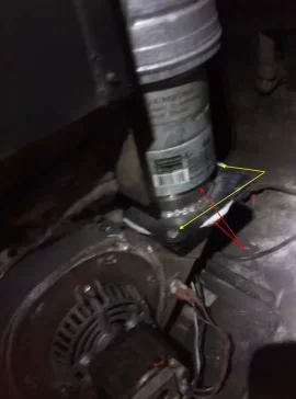

    Inserts have smaller hoppers and sometimes not no room for a T with a cleanout. So they need more filling and are harder to clean!
    Pic below shows exhaust blower so full of ash and had no draft so the stove would not light!

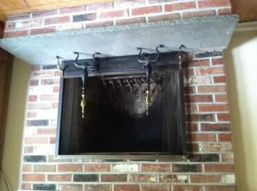

    Can you post a picture of the fireplace?

    Would I be better off with a free standing stove or an insert here?

    I think you will have to turn your house upside down for the pellet stove to work. :) Other than looks I cannot see any benefit of an insert over a free standing and I have an insert.

    Your going to have a tough time keeping the pellets in the hopper if you install the stove into that fire place!! ==c

    It's weird, the picture shows up correctly on my iPad but upside down on my PC.
