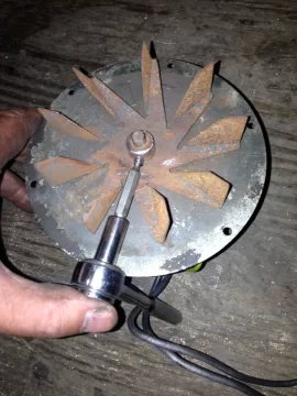

Harman exhaust blower impeller blades are easy to change. Usually it can be done with an allan wrench.
Here are some pics of the Harman combustion impeller blade removal.
https://www.hearth.com/talk/threads...ombustion-blower-what-is-the-best-way.109353/

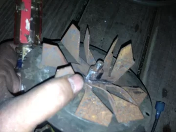

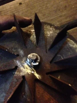

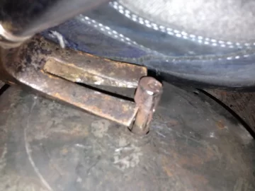

However other stoves where the combustion blower's impeller blades that are enclosed in an exhaust plenum or housing seem to be almost welded on from the heat!

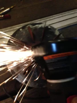

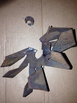

I finally got the the impeller off with the Air Cutter! Looks nice when done with the new impeller blade! Changing these impeller blades can be more of a challenge!

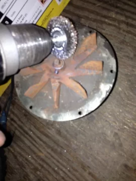

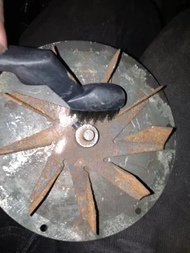

Here is what I tried.
PB Blaster, Wire Brushing and then the wrench did not crack it!

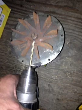

Drilling it out did not work very well either.
It finally took the air cutter making 2 cuts!
Click to Enlarge

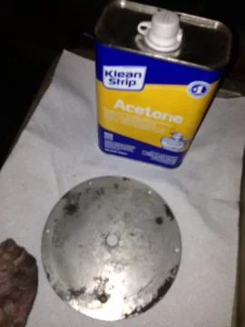

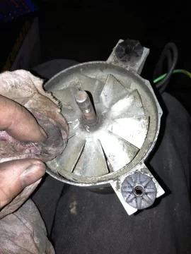

Hello

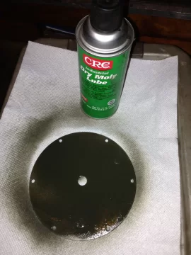

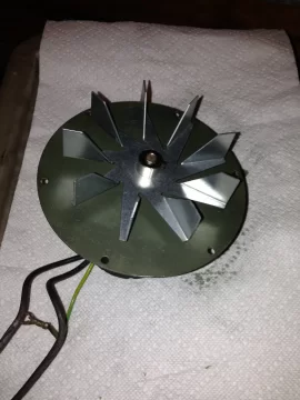

Here are the rest of the pics.
Then just some Acetone cleaner and some dry moly spray and a new impeller. Bingo!
Looks a little better now! Just a little more Dry Moly Spray!
