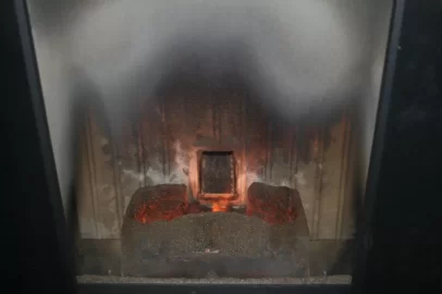

    Just took a pic of mine. I have over 30 bags through it no touch or open the door. Only filling the hopper and pulling the scraper rods on the heat exchanger. The cleaner the pellet the longer the run. Notice you can still see the fire and it spends all night just chuggin on low. That usually messes up a stove and the glass. IMG_0025.JPG
